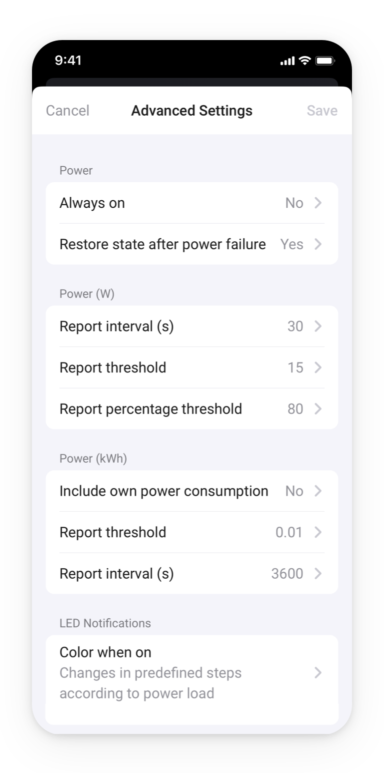

Device settings allow users to customize the behaviour of their devices from Homey.
Devices can have settings that can be changed by the user. These are presented to the user as Advanced settings. The device settings are defined in the /drivers/<driver_id>/driver.settings.compose.json file.

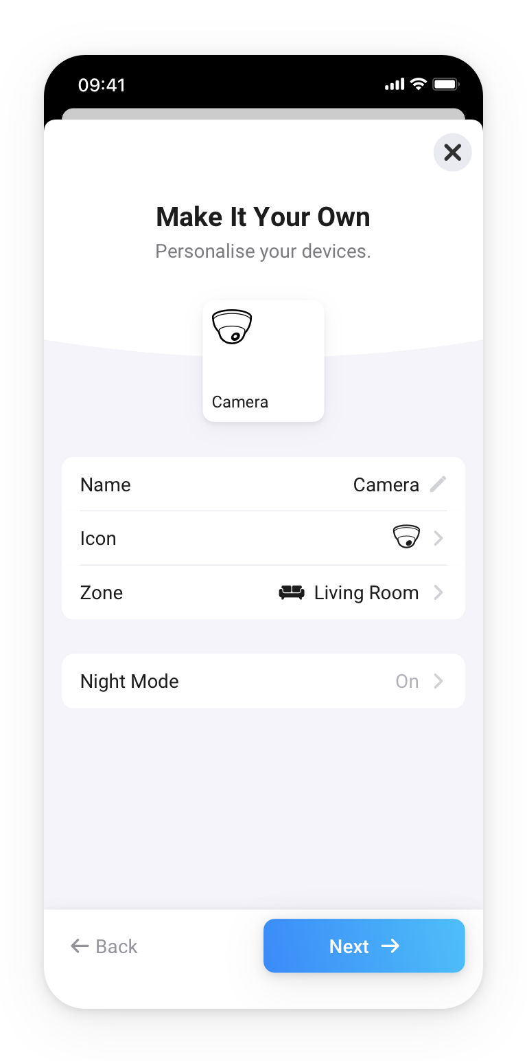

Highlighted settings
Highlighted settings for a camera device.
In an app with an extensive list of settings, it can be challenging for users to locate the most important ones. To address this, there's an option to display key settings in a separate list during the pairing of a new device. This feature, called "Highlighted Settings," helps users quickly find the most essential settings.
To highlight a settings item, simply add "highlight": true to the item in your settings JSON file.
