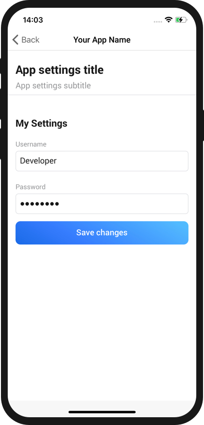

Example
Below is a simple example to save a username & password. Learn more about HTML usage and CSS styling.
