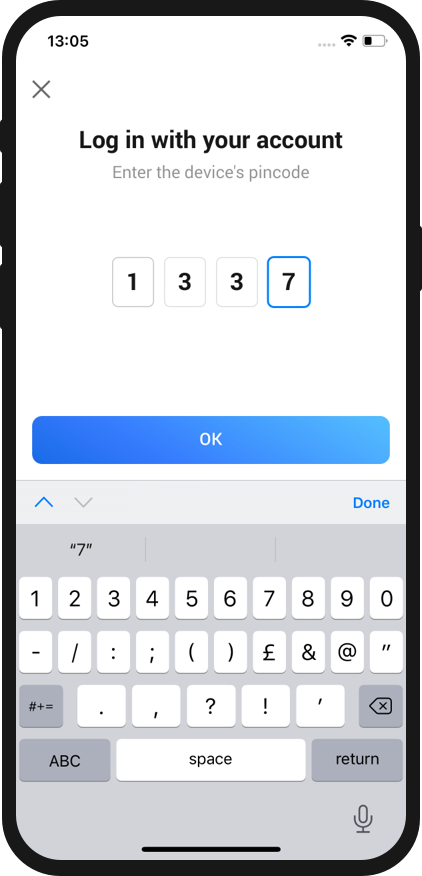

This pair template shows a pincode input. When the pincode is correct, it will proceed to the next view.
**Usage:** `"template": "pincode"`
