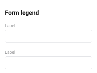

### Fieldset and legend
With `<fieldset class="homey-form-fieldset">` you can create a new fieldset in your form.\
A fieldset is useful to create larger sections in your forms. Make sure your always use a `<legend class="homey-form-legend">` to give the fieldset a title.
<table><thead><tr><th width="253">CSS class</th><th>HTML</th></tr></thead><tbody><tr><td><code>.homey-form-fieldset</code></td><td><pre class="language-html" data-overflow="wrap"><code class="lang-html">&#x3C;fieldset class="homey-form-fieldset">&#x3C;/fieldset>
</code></pre></td></tr><tr><td><code>.homey-form-legend</code></td><td><pre class="language-html"><code class="lang-html">&#x3C;legend class="homey-form-legend">&#x3C;/legend>
</code></pre></td></tr></tbody></table>
#### Example
<div align="left"><figure><img src="https://998911913-files.gitbook.io/~/files/v0/b/gitbook-x-prod.appspot.com/o/spaces%2F-MPk9cn4V7WnnKt7fbry%2Fuploads%2Fgit-blob-bf215113406b5b62d1d6a6b449747162aac5ebb0%2Fform-legend.png?alt=media" alt=""><figcaption><p>Use a <code>homey-form-legend</code> to create headings between form elements.</p></figcaption></figure></div>
{% code lineNumbers="true" %}
```html
  <legend class="homey-form-legend"></legend>
</fieldset>
{% endcode %}

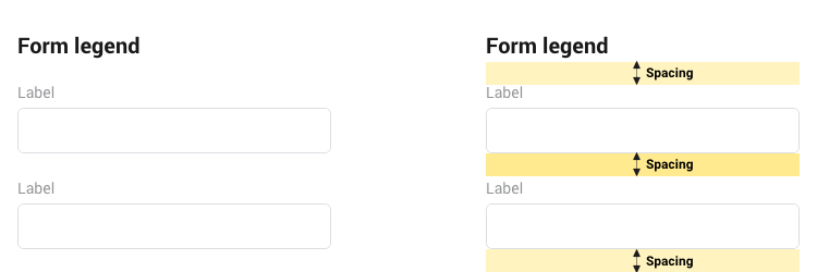

### Groups
Use `<div class="homey-form-group">` to create a group combining a label with an input field. Use the `homey-form-group` class to create equal vertical spacing between all inputs.
<table><thead><tr><th width="231">CSS class</th><th>HTML</th></tr></thead><tbody><tr><td><code>.homey-form-group</code></td><td><pre class="language-html" data-overflow="wrap"><code class="lang-html">&#x3C;div class="homey-form-group">&#x3C;/div>
#### Example
<div align="left"><figure><img src="https://998911913-files.gitbook.io/~/files/v0/b/gitbook-x-prod.appspot.com/o/spaces%2F-MPk9cn4V7WnnKt7fbry%2Fuploads%2Fgit-blob-33955236e6d0dc26b65b0de091c155fbbf458447%2Fform-group-spacing.png?alt=media" alt=""><figcaption><p>The yellow space marks the spacing above and below each <code>.homey-form-group</code> class</p></figcaption></figure></div>
<pre class="language-html" data-line-numbers><code class="lang-html"><strong>&#x3C;div class="homey-form-group">
</strong>  &#x3C;label class="homey-form-label" for="target">label&#x3C;/label>
  &#x3C;input class="homey-form-input" id="target" type="text" value=""/>
<strong>&#x3C;/div>
</strong></code></pre>

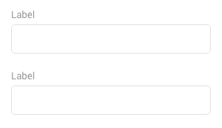

### Basic input & label
<table><thead><tr><th width="231">CSS class</th><th>HTML</th></tr></thead><tbody><tr><td><code>.homey-form-label</code></td><td><pre class="language-html" data-overflow="wrap"><code class="lang-html">&#x3C;label class="homey-form-label" for="target">&#x3C;/label>
</code></pre></td></tr><tr><td><code>.homey-form-input</code></td><td><pre class="language-html" data-overflow="wrap"><code class="lang-html">&#x3C;input class="homey-form-input" id="target" type="text" value=""/>
</code></pre></td></tr><tr><td></td><td>Can be used for the input types: <code>text</code>, <code>number</code>, <code>password</code> and <code>url</code> .</td></tr></tbody></table>
#### Example
<div align="left"><figure><img src="https://998911913-files.gitbook.io/~/files/v0/b/gitbook-x-prod.appspot.com/o/spaces%2F-MPk9cn4V7WnnKt7fbry%2Fuploads%2Fgit-blob-03116aae62919ccae21ab091217f44872a798651%2Fform-input-label.png?alt=media" alt=""><figcaption><p>Basic label + input example</p></figcaption></figure></div>
<pre class="language-html" data-line-numbers><code class="lang-html">&#x3C;form class="homey-form">
    &#x3C;legend class="homey-form-legend">Login data&#x3C;/legend>
<strong>      &#x3C;label class="homey-form-label" for="username">Username&#x3C;/label>
</strong><strong>      &#x3C;input class="homey-form-input" id="username" type="text" value=""/>
</strong>    &#x3C;/div>
<strong>      &#x3C;label class="homey-form-label" for="password">Password&#x3C;/label>
</strong><strong>      &#x3C;input class="homey-form-input" id="password" type="password" value=""/>
    &#x3C;!-- ... -->
</code></pre>

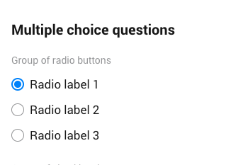

#### Example
<div align="left"><figure><img src="https://998911913-files.gitbook.io/~/files/v0/b/gitbook-x-prod.appspot.com/o/spaces%2F-MPk9cn4V7WnnKt7fbry%2Fuploads%2Fgit-blob-9221cce8e4dc66d74f032fffbefdb405fe187ffe%2Flegend%2Bradio-buttons.png?alt=media" alt=""><figcaption><p>Radio buttons should be grouped in fieldsets. You can use multiple levels of fieldsets with different classes.</p></figcaption></figure></div>
```html
<form class="homey-form">
    <legend class="homey-form-legend">Multiple choice questions</legend>
      <fieldset class="homey-form-radio-set">
        <legend class="homey-form-radio-set-title">Group of radio buttons</legend>
        <label class="homey-form-radio">
          <input class="homey-form-radio-input" type="radio" name="radio-example"/>
          <span class="homey-form-radio-checkmark"></span>
          <span class="homey-form-radio-text">Radio label 1</span>
        </label>
          <span class="homey-form-radio-text">Radio label 2</span>
        </label>
          <span class="homey-form-radio-text">Radio label 3</span>
        </label>
      </fieldset>
    </div>
{% endcode %}

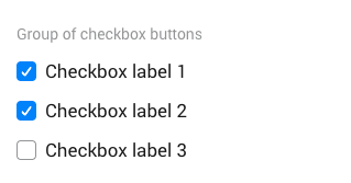

### Checkbox input
#### Checkbox set
<table><thead><tr><th width="350">CSS class</th><th>HTML</th></tr></thead><tbody><tr><td><code>.homey-form-checkbox-set</code></td><td><pre class="language-html" data-overflow="wrap"><code class="lang-html">&#x3C;fieldset class="homey-form-checkbox-set">&#x3C;/fieldset>
</code></pre></td></tr><tr><td><code>.homey-form-checkbox-set-title</code></td><td><pre class="language-html" data-overflow="wrap"><code class="lang-html">&#x3C;legend class="homey-form-radio-checkbox-set-title">&#x3C;/legend>
#### Checkboxes
<table><thead><tr><th width="323">CSS class</th><th>HTML</th></tr></thead><tbody><tr><td><code>.homey-form-checkbox</code></td><td><pre class="language-html" data-overflow="wrap"><code class="lang-html">&#x3C;label class="homey-form-checkbox">&#x3C;/label>
</code></pre></td></tr><tr><td><code>.homey-form-checkbox-input</code></td><td><pre class="language-html" data-overflow="wrap"><code class="lang-html">&#x3C;input class="homey-form-checkbox-input">&#x3C;/input>
</code></pre></td></tr><tr><td><code>.homey-form-checkbox-checkmark</code></td><td><pre class="language-html" data-overflow="wrap"><code class="lang-html">&#x3C;span class="homey-form-checkbox-checkmark">&#x3C;/span>
</code></pre></td></tr><tr><td><code>.homey-form-checkbox-text</code></td><td><pre class="language-html"><code class="lang-html">&#x3C;span class="homey-form-checkbox-text">&#x3C;/span>
#### Example
<div align="left"><figure><img src="https://998911913-files.gitbook.io/~/files/v0/b/gitbook-x-prod.appspot.com/o/spaces%2F-MPk9cn4V7WnnKt7fbry%2Fuploads%2Fgit-blob-5759097403494f5dab453adb4691941787e5576f%2Flegend%2Bcheckbox.png?alt=media" alt=""><figcaption></figcaption></figure></div>
```html
  <fieldset class="homey-form-checkbox-set">
    <legend class="homey-form-checkbox-set-title">Group of checkbox buttons</legend>
    <label class="homey-form-checkbox">
      <input class="homey-form-checkbox-input" type="checkbox" name="checkbox-example"/>
      <span class="homey-form-checkbox-checkmark"></span>
      <span class="homey-form-checkbox-text">Checkbox label 1</span>
    </label>
      <span class="homey-form-checkbox-text">Checkbox label 2</span>
    </label>
      <span class="homey-form-checkbox-text">Checkbox label 3</span>
    </label>
  </fieldset>
</div>
{% endcode %}

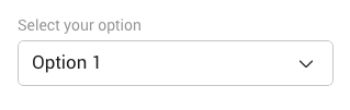

### Select
<table><thead><tr><th width="246">CSS class</th><th>HTML</th></tr></thead><tbody><tr><td><code>.homey-form-select</code></td><td><pre class="language-html" data-overflow="wrap"><code class="lang-html">&#x3C;select class="homey-form-select">
  &#x3C;option value="1">Option 1&#x3C;/option>
&#x3C;/select>
#### Example
<div align="left"><figure><img src="https://998911913-files.gitbook.io/~/files/v0/b/gitbook-x-prod.appspot.com/o/spaces%2F-MPk9cn4V7WnnKt7fbry%2Fuploads%2Fgit-blob-876416e004e21da6c085a7a3e6bcd5abf36f637d%2Fselect.png?alt=media" alt=""><figcaption></figcaption></figure></div>
```html
  <label class="homey-form-label" for="select-example">Select your option</label>
  <select class="homey-form-select" name="select-example" id="select-example">
    <option value="1">Option 1</option>
    <option value="2">Option 2</option>
    <option value="3">Option 3</option>
  </select>
</div>
{% endcode %}

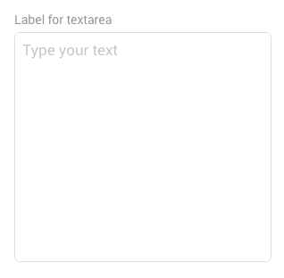

### Textarea
<table><thead><tr><th width="246">CSS class</th><th>HTML</th></tr></thead><tbody><tr><td><code>.homey-form-textarea</code></td><td><pre class="language-html" data-overflow="wrap"><code class="lang-html">&#x3C;textarea class="homey-form-textarea">&#x3C;/textarea>
#### Example
<div align="left"><figure><img src="https://998911913-files.gitbook.io/~/files/v0/b/gitbook-x-prod.appspot.com/o/spaces%2F-MPk9cn4V7WnnKt7fbry%2Fuploads%2Fgit-blob-24779a21ace7050435367ad2992c7fab1e6f03dc%2Ftextarea.png?alt=media" alt=""><figcaption></figcaption></figure></div>
```html
  <label for="textarea-example-1" class="homey-form-label">Label for textarea</label>
  <textarea class="homey-form-textarea" name="textarea-example-1" id="textarea-example-1" rows="10"
            placeholder="type here your text"></textarea>
</div>
{% endcode %}

#### Example
<div align="left"><figure><img src="https://998911913-files.gitbook.io/~/files/v0/b/gitbook-x-prod.appspot.com/o/spaces%2F-MPk9cn4V7WnnKt7fbry%2Fuploads%2Fgit-blob-bab397513cf38e91a083c759bfe932d6fddb42c0%2FLoading.gif?alt=media" alt=""><figcaption><p><code>.homey-button-primary-full.is-loading</code></p></figcaption></figure></div>
