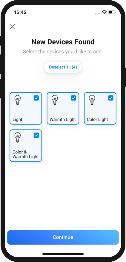

This view will show a list of selectable devices to the user. Devices that have already been paired with Homey will automatically be filtered out, based on their data property.
**Usage:** `"template": "list_devices"`
<figure><img src="https://998911913-files.gitbook.io/~/files/v0/b/gitbook-x-prod.appspot.com/o/spaces%2F-MPk9cn4V7WnnKt7fbry%2Fuploads%2Fgit-blob-2f772da7c42082a8debc618de010ccdc2aceb835%2Flist-devices.png?alt=media" alt=""><figcaption></figcaption></figure>
