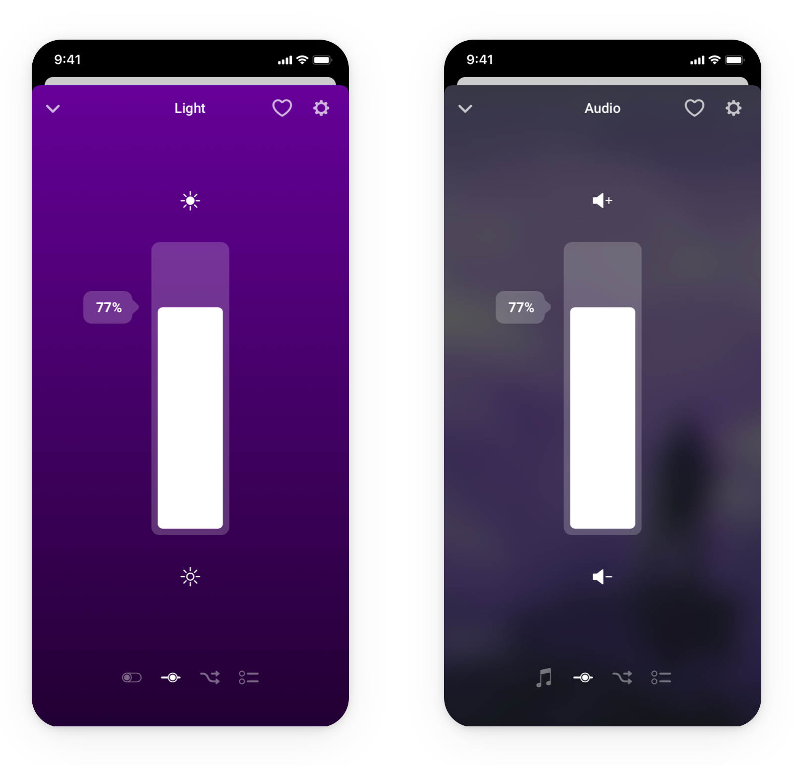

### Slider
`"uiComponent": "slider"`
The slider component displays one `number` capability. Depending on the capability, the look might change.
<figure><img src="https://998911913-files.gitbook.io/~/files/v0/b/gitbook-x-prod.appspot.com/o/spaces%2F-MPk9cn4V7WnnKt7fbry%2Fuploads%2Fgit-blob-cfe5301b8abdbd8e43869452f4caff6fa1b9ad79%2Fdriver-capability-ui-slider.png?alt=media" alt=""><figcaption></figcaption></figure>

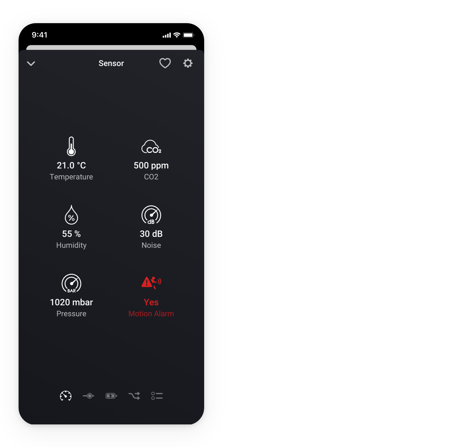

### Sensor
`"uiComponent": "sensor"`
The sensor component displays multiple `number`, `enum`, `string` or `boolean` capabilities.
Booleans that are `true` and begin with `alarm_` will flash red.
<figure><img src="https://998911913-files.gitbook.io/~/files/v0/b/gitbook-x-prod.appspot.com/o/spaces%2F-MPk9cn4V7WnnKt7fbry%2Fuploads%2Fgit-blob-1b1acff5a223a651f8b9fdd0c3c66e59fc481044%2Fdriver-capability-ui-sensors.png?alt=media" alt=""><figcaption></figcaption></figure>

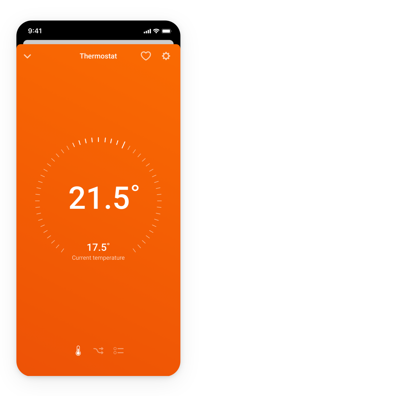

### Thermostat
`"uiComponent": "thermostat"`
The thermostat component displays a `target_temperature` capability, and an optional `measure_temperature`.
If you use sub-capabilities for `target_temperature` and `measure_temperature`, make sure the dot suffix of the capabilities are the same so that they will be displayed together, for instance: `target_temperature.top` and `measure_temperature.top`.
<figure><img src="https://998911913-files.gitbook.io/~/files/v0/b/gitbook-x-prod.appspot.com/o/spaces%2F-MPk9cn4V7WnnKt7fbry%2Fuploads%2Fgit-blob-0b053d9f259bedc2075470549053725030909ad0%2Fdriver-capability-ui-thermostat.png?alt=media" alt=""><figcaption></figcaption></figure>

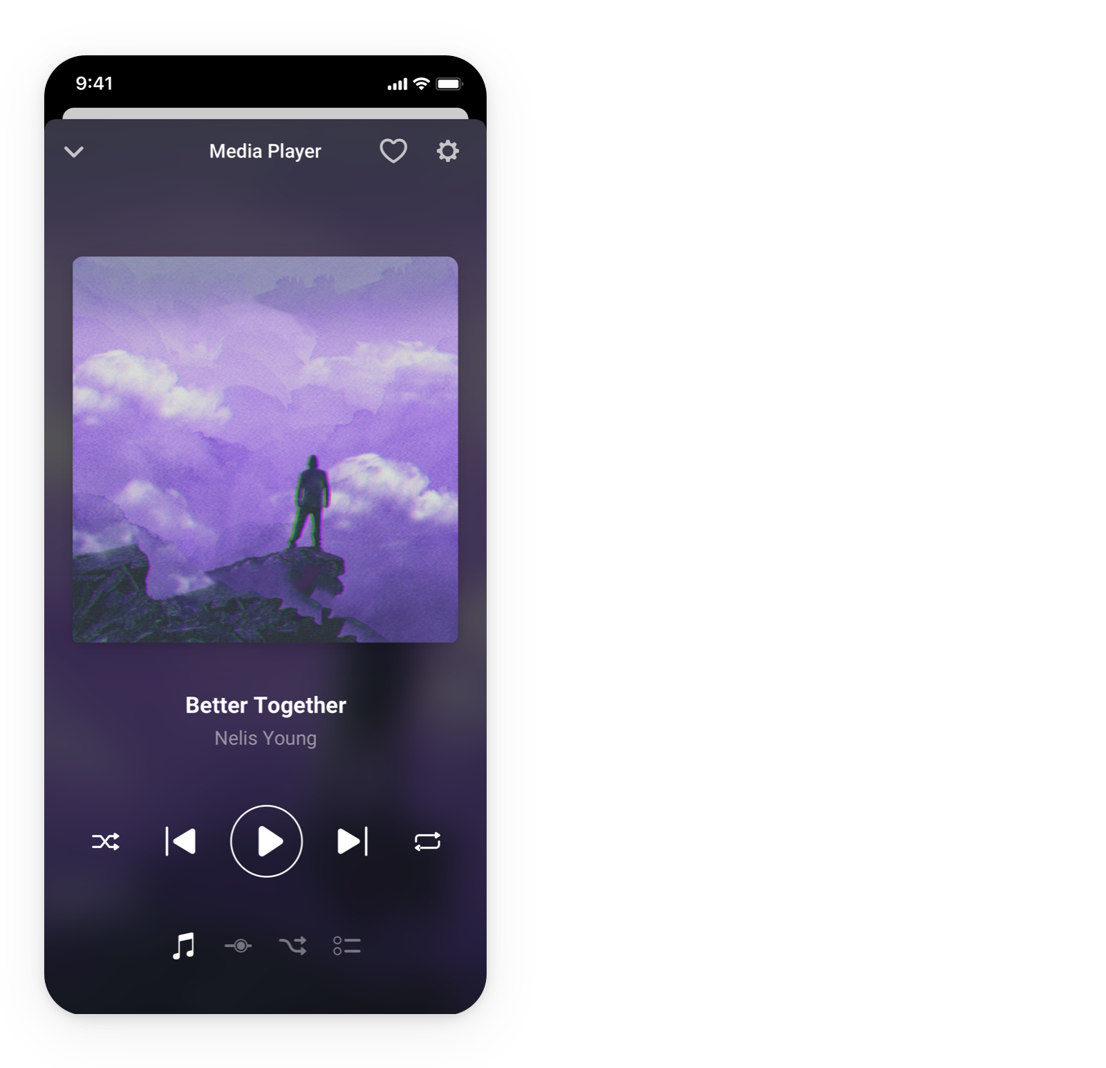

### Media
`"uiComponent": "media"`
The media component accepts the `speaker_playing`, `speaker_next`, `speaker_prev`, `speaker_shuffle` and `speaker_repeat` capabilities.
Additionally, it shows the album art as set using [`Device#setAlbumArt()`](https://apps-sdk-v3.developer.homey.app/Device.html#setAlbumArt) or [`Device#set_album_art_image()`](https://python-apps-sdk-v3.developer.homey.app/device.html#homey.device.Device.set_album_art_image).

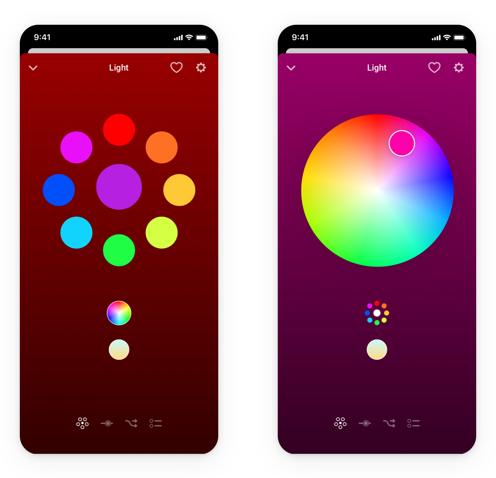

### Color
`"uiComponent": "color"`
The color component accepts the `light_hue`, `light_saturation`, `light_temperature` and `light_mode` capabilities.

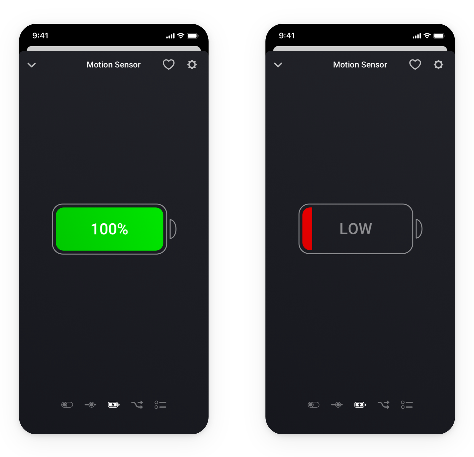

### Battery
`"uiComponent": "battery"`
The battery component accepts either a `measure_battery` or `alarm_battery` capability.

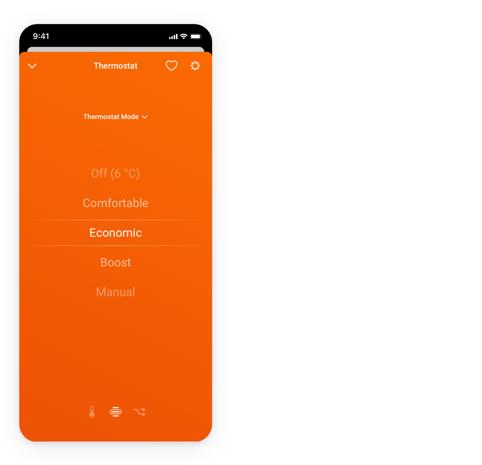

### Picker
`"uiComponent": "picker"`
The picker component accepts one `enum` capability and shows a list of possible values. Make sure the values titles fit on one line and are never more than 3 words.
<figure><img src="https://998911913-files.gitbook.io/~/files/v0/b/gitbook-x-prod.appspot.com/o/spaces%2F-MPk9cn4V7WnnKt7fbry%2Fuploads%2Fgit-blob-aaaee327939dc4626d0a34758d7c6955a49e7d03%2Fdriver-capability-ui-picker.png?alt=media" alt=""><figcaption></figcaption></figure>

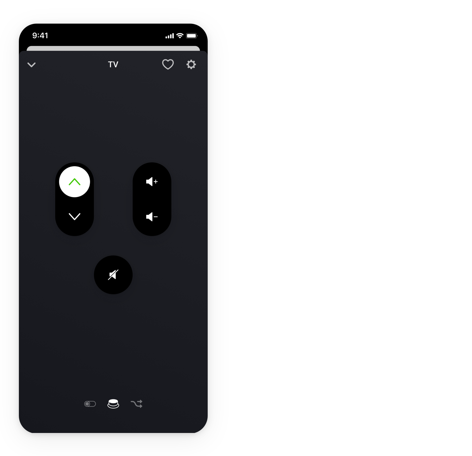

### Button
`"uiComponent": "button"`
The button component displays one or more `boolean` capabilities. Depending on the capability, the look might change. Most buttons are stateless but it is possible to add a stateful button if the capability is both `setable` and `getable`. Some buttons will be grouped together like volume\_up and volume\_down.
<figure><img src="https://998911913-files.gitbook.io/~/files/v0/b/gitbook-x-prod.appspot.com/o/spaces%2F-MPk9cn4V7WnnKt7fbry%2Fuploads%2Fgit-blob-6e4ff76c33ff211a97796ded788b2cb2c7a607de%2Fdriver-capability-ui-button.png?alt=media" alt=""><figcaption></figcaption></figure>

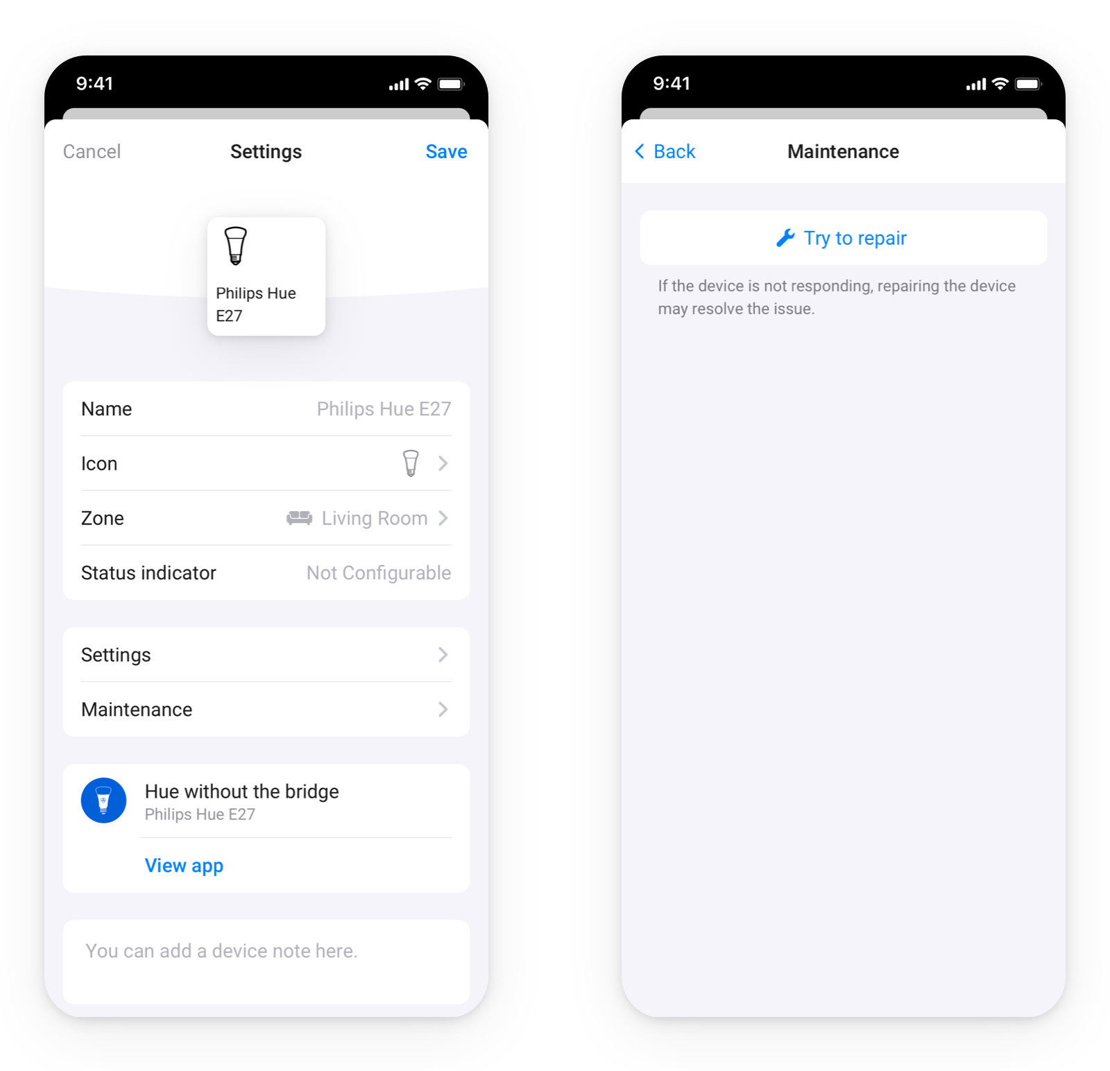

## Maintenance Actions
> This feature depends on Homey v3.1.0 and Homey Smartphone App v3.0.1.
Button capabilities can be flagged as maintenance action. This will show a button in 'Device settings > Maintenance actions' and hide the `uiComponent` in the device view. When this button is pressed the registered capability listener will be triggered. This allows you to initiate actions from the device's settings.
Example use cases:
* Starting the calibration process on a device
* Resetting accumulated power measurements
<figure><img src="https://998911913-files.gitbook.io/~/files/v0/b/gitbook-x-prod.appspot.com/o/spaces%2F-MPk9cn4V7WnnKt7fbry%2Fuploads%2Fgit-blob-08c85274efbf6ba4a15e21414fe1daa1cd35ffc1%2Fdriver-capability-ui-maintenance.png?alt=media" alt=""><figcaption></figcaption></figure>
### Creating a maintenance action
A maintenance action capability must be a capability that extends the system capability `button`. In order to mark it as a maintenance action add the `maintenanceAction: true` property to the `capabilitiesOptions` object of the driver manifest. Additionally, provide a `title` property, and optionally a `desc` property.
